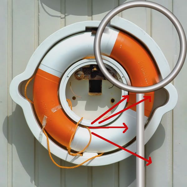

I am trying to make a magnifying glass filter get ugly shadows with hard edges on some parts.
I posted a screenshot of the filter here, but I saw, some people posted the filters directly. I could not figure out how to do that. If someone can tell me how to post filters, i will do that.
I really would appreciate, if someone could give me some advice.

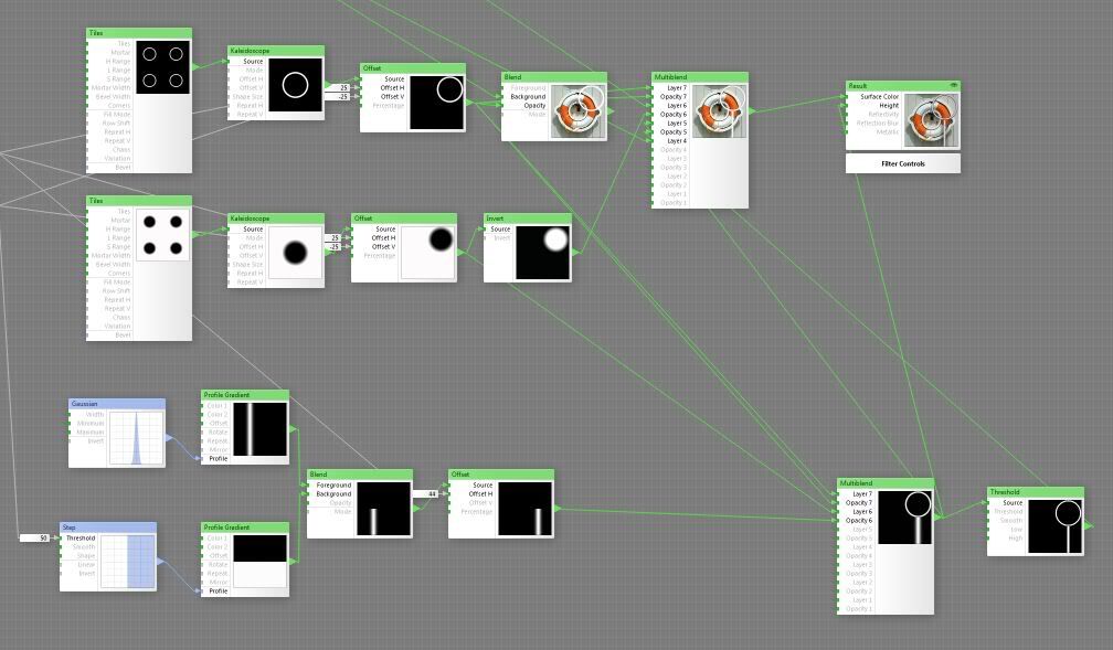

Here it is!
Thank you! These filters are well hidden on the Computer.
magnifying glass2.ffxml
to get rid of the edge under the lens, swap the step curve for an impulse so you can move the edge up which hides the edge by the ring of the lens. Put in a threshold and adjust your caussian for the 2 to match. Anyway other may suggest better ways smile;)
in fact you can just put in the threshold and adjust the causian smile;) smile:)

I did it like this. Not 100% perfect though.

Thank you so much Carl and Totte! So there are two entirely different ways to do it. It already looks great in your version, Totte. I had not even discovered the alpha slider yet.
I want to add some detail now and beautify it a bit. smile:)
I think you'd find there would be many different ways to solve it, look forward to seeing your final version smile:)
