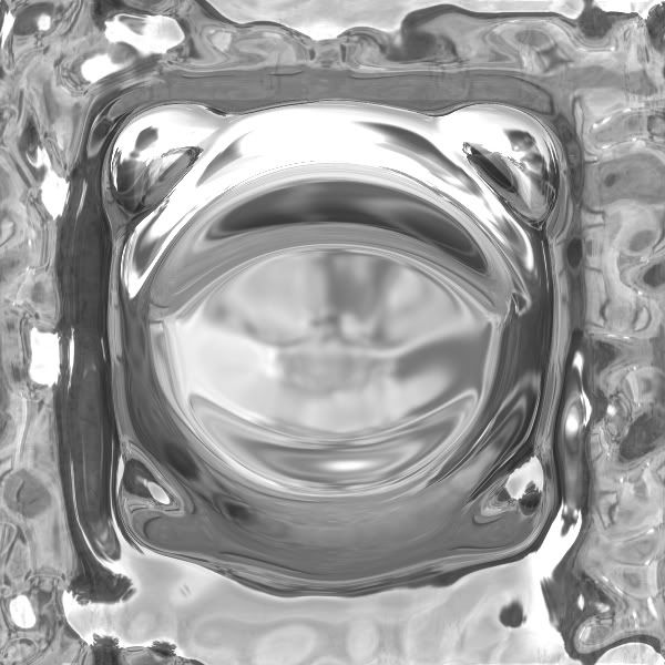

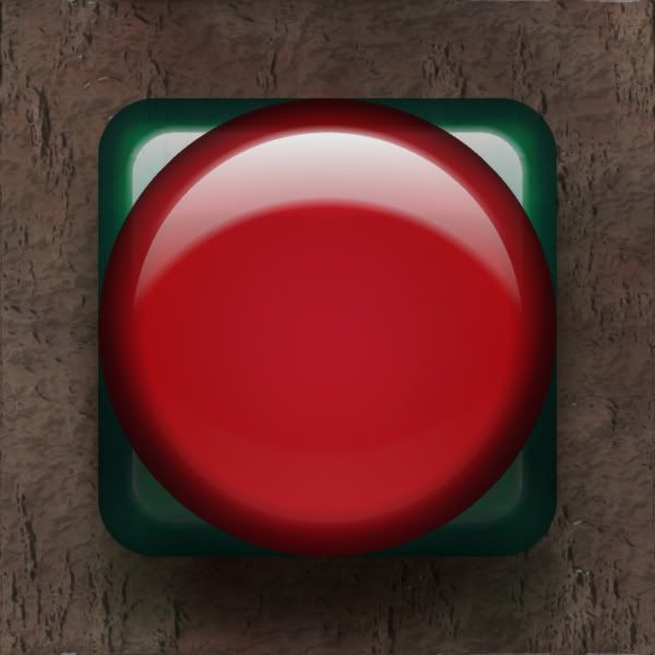

for example this is a base image for the next example, it is just a wall with a couple of iterations of the aqua button.
This one is the same image with the 'bridge' hdri lighting choice in advanced metalizer with all color desaturated.
And this one is with the non true hdri image of T2 from my HD with all the same settings.
So as you can see it does not have to actually be an hdri image to get differing results, however actual hdri images are just that much more powerful.
