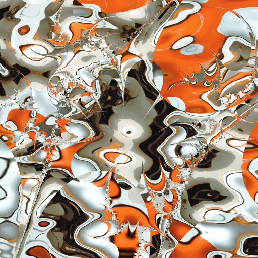

For example I want to know if you can animate the distortion values of this filter that is for FF 7. So the animation would start and show the default FF Lifesaver source image without any distortion and then progressively would begin the distortion until you reach the preset shown here below
Or Begin fr om an already distorted value and go to another value
Dragon Distort II By Wolfgang Halder

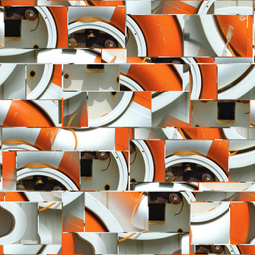

EXAMPLE 4
Could be done an animation wh ere the blocks created by this filter are moving ?
SuperCastleBlocks By Orestes

Hello SpaceRay,
yes it is possible to change the filter Dragon Distort II to the filter you wanted to have. And you don´t need to upgrade to the newest version of Filter Forge. I have just uploaded the filter Dragon Distort II Animate version to the queue. So watch out for new filters.
Wolfgang Halder
Wolfgang Halder
Posts: 68
Filters: 78
The filter Dragon Distort II Animate is out now. Here is the link:
https://filterforge.com/filters/16106.html
