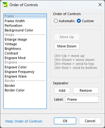

I have seen that either in FF 9.0 and also in FF 10.0 beta there is an error
If you go to filter editor in FF 10 mac version and then go to menu Filter ---> Order Of Controls
You see that to send a control to the top or bottom is shown the keys
⌘ plus Home
on Mac there is no real home button but the equivalent for this is the Right Arrow (on the wireless keyboard) but this does not work in FF and nothing happens when you use these two keys because the real and true combination that works in FF is these 3 keys
fn plus ⌘ plus Left (with this combination it works correctly and sends the control to the top)
fn plus ⌘ plus Right (with this combination it works correctly and sends the control to the bottom)
So I suggest to fix, change and replace the following
⌘Home ----> with ----> fn⌘Left
⌘End ----> with ----> fn⌘Right
Or instead it could maybe changed the code input could be configured maybe to the real keys combinations of Home and End in Mac
fnLeft
fnRight
this is shown The “Home” & “End” Button Equivalents on Mac Keyboards
