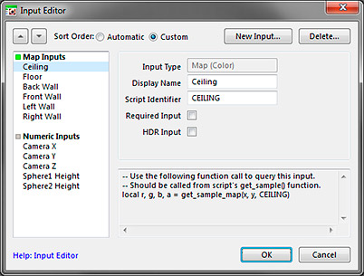

I initially wanted to adapt the current Order of Controls dialog for this purpose, but it turned out to be difficult, mostly because of the fact that group inputs can be sortable only within their type group (Map inputs, Numeric inputs, Curve inputs), while the current dialog doesn't have any type bounds in its list.
Most likely we'll implement an additional separate dialog to deal with this.

The dialog would use the same type-separated list of controls as we used in the Script Input Editor (though the general design would resemble Order of Controls).
As for the visions, well, I am smile:)
Looks good, Vlad! smile:)
