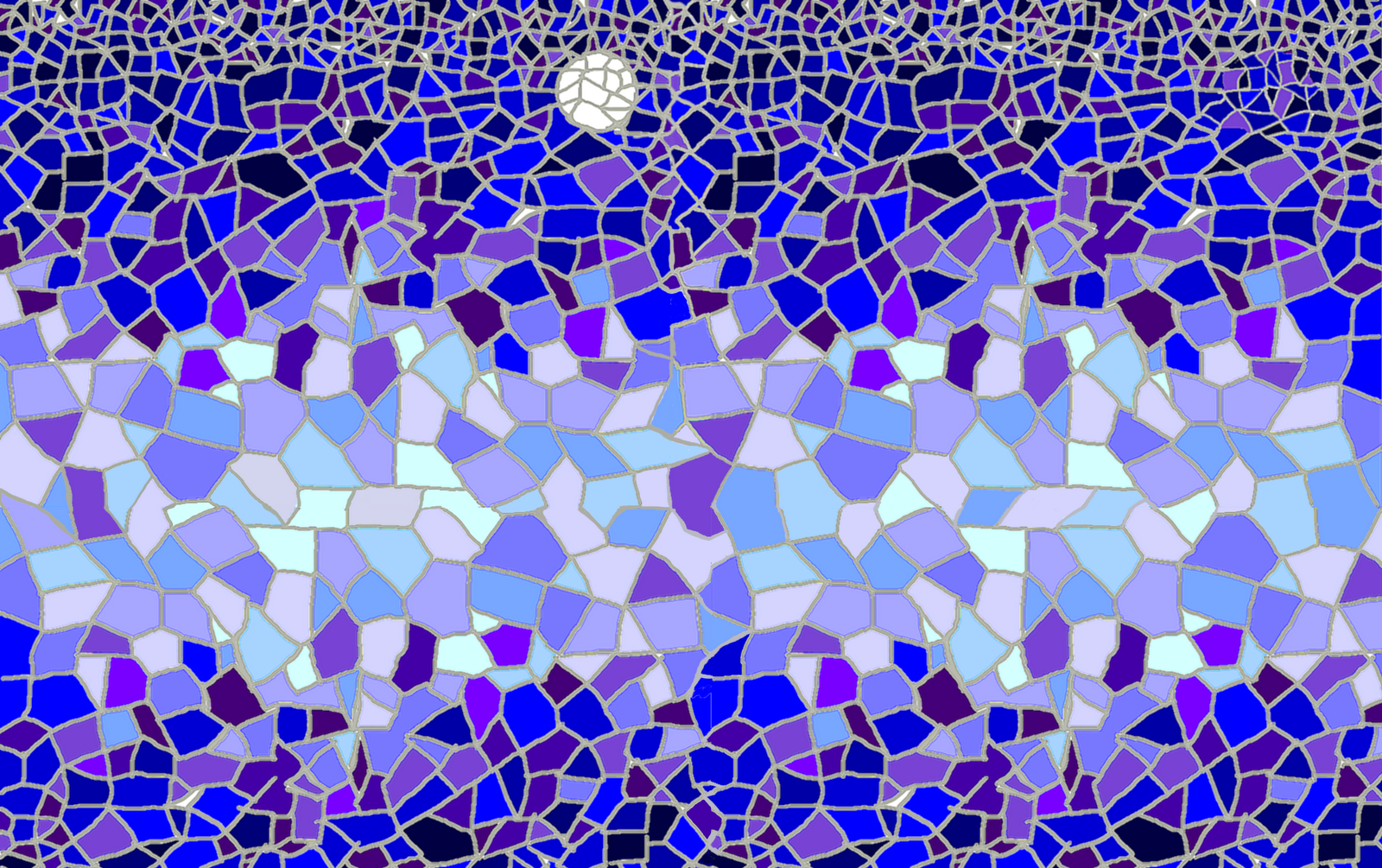

smile:D (Prize if you can figure out how I did it)
Looks like it has something to do with cell noise. Other than that, your guess is as good as mine smile:D
Here. Now where's my prize smile:D
Well you're half way there. Now make the cells completely irregular while almost touching. smile:D
Just a bit of tweaking...
The resemblence is uncanny! smile:D
This looks beatiful and delicate with organical round bubble shapes for stones. Like it much
It reminds me in some way to the Antoni Gaudi Mosaics like for example this one
BUT yours have beautiful round "ceramics" instead of straight hard edges, well done.
Surely you have used one of your many surprising tricks and hacks to make this in a different way than the usual one

Oh, I was SO close!
I also had Elipse connected to Bomber. smile8)
There ends the resemblance.... smile:D

OH, I see, then I also was close to guessing it, I have used also the RESULT component the same like he has done it. smile:D
