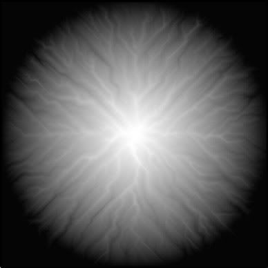

Here are a few tips on doing fluvial-like erosion in FF, that I've discovered so far:
1) Cleaving.
Notice how a perfect sphere when run through the erosion device in Bryce in non-uniform?
There is asymmetry introduced into the system for a reason.
When I posted this image on the last page:
The cleaving method I was using was a non-gaussian Blur (square) attached to a Percentile component. It did a good job, but there were unnecessary rectangular(ities). You can flip them 45 degrees and blend, but sill not the ideal. Then it occurred to me that the Noise Distortion component was the best cleaving device.

2) Source.
Starting with an adequate source image may make the cleaving requirement obsolete. If you want to erode an image of a Lionfish, then you will probably need to use cleaving, but if you have a multi-fractal noise as the source then you can proceed without it. There is uncertainty about what characteristics a noise must have to be best suited for an eroded terrain, and this is going to require much more investigation. The following source took 52 seconds to render at 1200 x 1200 px 25 AA and uses a 2 iteration offset method. It is shown as displaced/rendered in Blender and is used as the starting comparison to the subsequent eroded images.

3) Looped Bitmap-based components not necessary.
Initially the high quality erosion method I envisioned, made use of Bitmap-based components in the loop, so I had to get one image output sent back to the input and repeat. See:
https://www.filterforge.com/features/v...sions.html
"Bitmap-based components such as Blur, Sharpen or High Pass cannot be used inside the loop. That would require rebuilding the entire input and output bitmap caches for each such component for each loop iteration, which would lead to insane memory requirements."
As I was testing the differences in the methods (preset 1 = manual loop, preset 2 = loop without Bitmap-based components):

It seemed like maybe there was a way to get one to look like the other. A major consideration was the speed of the process. 10 minutes versus 1 was enough to keep me whittling this stick. Then as I was seeing that some middle ground between the deep channels and the flat plains was the ideal:

4) Approach FF as more of a science than an art.
While the output of FF and other computer art softwares can be considered art, the method to create such visuals is not. If you are passionate about art and you can put your emotions into your work, by all means pick up a paint brush and have fun. But this is computer science, and as such if you want to successfully create stunning visuals, be prepared for a very dry and stern set of strictures and a lot of them. Make careful note of what doesn't work and why, and chart your course methodically forward. Lecture off. Graphics on!
Indeed a rough approximation of fluvial erosion can be had in FF without needing Bitmap-based components in the loop. Not the beautiful smooth deep channels, but something that does make me smile that in 52 seconds (2 iteration source generation) plus 31 seconds (10 iteration erosion) equals FF is nice:

So let me see if I'm understanding what has happened to get the stylized mountain look you named Erosiom.
Open BryceErosion4.jpg~original 388 x 388 in FF, do not upres it
Then apply a preset 1 or 2 from another FF filter (I don't know the name of that filter that's showing lionfish)
Then manualy apply that unknown filter 10 times rather than a loop componant.
Then set FF to output to give a 1200 x 1200 hieght or/alpha/bumpmap
Then from that map make an FF normal map by bump to normal at the link you mentioned.
Then both 1200 x 1200 maps are used in blender to give the final stylized mountain scene that you named Erosiom
Am I following ok? seems I may be missing a thing or 2

The process for http://www.xirja.com/Erosion.jpg is just:
1. Create mountain like noise in FF
2. Erode in FF
3. Displace in Blender
Of course the first two steps are not that easy in and of themselves, but...
- Bryce was not used at all. I referenced that image because it was a simple example of the erosion effect. The starting source was more like https://www.filterforge.com/upload/for...aphic1.jpg
(it is a custom private filter made by me and not by Sphinx, despite what the image says).
- The Lionfish image shows the 'Fluvial' erosion filter at work (again another custom private filter). For the best results, the 'Fluvial' erosion filter, as you said, is manually run multiple times.
- From the beginning of the process, the image size should be the size you want, or greater.
- The normal issue is internal to the 'Fluvial' erosion process. The regular B&W output from FF is used for bump coloring and displacement in Blender. EXR or TIFF 32-bit float formats have the least visible banding due to rounding.
The only public filter that I know of, that comes the closest to steps one or two, is https://www.filterforge.com/filters/12449.html, but even she was asking how I did this. smile;)

Posts: 1698
River systems:
_____________________________________________________
http://web.archive.org/web/2021062908...rjadesign/
xirja
Idididoll Forcabbage
Posts: 1698
and of course, still putting it all together...
