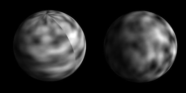

It's for making texture maps for planets and other spherical objects without seams and minimum distortion. Alright, I'll render a sample so you get the idea.
Okay, here you can see what it does (as Mousewrites explained):
On the left you see the result from mapping (or wrapping) a regular noise texture on a sphere; you get distortion at the poles (as well as equator) and a seam. The seam you can get rid of in FF by making a seamless texture, but the distortions remain.
To the right, planetary noise wrapped onto a sphere.
