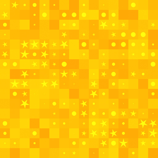

Now here is a cool, useful and great way to animate objects with bomber in a grid, and it can be used for many different things
Animated Pattern by Kochubey
And here is an animated preview thanks to CFandM that shared it
CFandM wrote:
Here is a basic animation without any edits to the filter......
It is interesting to see how it was done using a Normalized time component to animate the perlin noise that is then connected to the chances in bomber
