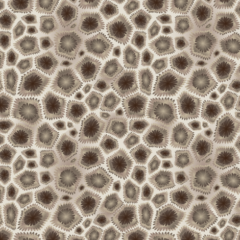

Do you know Petoskey stones?
They are fossil corals. You can read a description here : Petoskey stone
They can be a nice idea for a new filter.
Here is some photo to show it :
Filters: 711
Here is some graphic example :
The look is someway similar to Cells.

CFandM already has this in the library: Petoskey Stone
Nice photos though. smile:)

Yes I do... smile;)
Petoskey stones
Beat me to it xirja...Must have been posting at the same time... smile;) smile:)

From the examples Ramlyn has put, it seems that these stones have different sizes in the hexagons textures, and they keep being tight, although it seems also the grout or lines separating the hexagons can be diferent width
In the well done and nice filter by CFandM it seems that all the hexagons are nearly the same size with the beatiful texture! And do not know if the lines (grout) in between can be resized and keep all right
So maybe I think that it can be improves and made it more like the real petoskey stones
So it can be a challenge to see who can make an even better filter That gets more closer to the real images shown here above
