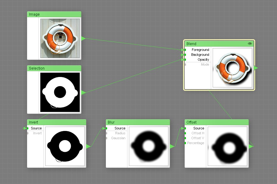

I have thought that as there is still some overlapping, it would be good idea perhaps to add some drop shadows and add some depth and separate the particles in layers, but when adding the drop shadows I got a bad thing, the result takes nearly 4 TIMES MORE to render than without shadow and is only using one blur component
I have used the most simple drop shadow as shown by crapadilla in his wiki page
If Threedee was thinking that his filter was slow, wait until you add drop shadows this way and multiply nearly by four the time smile:D smile:cry:

Thanks to Skybase that have made me go the right way, when I have seen that it was much better to put the shadows AFTER the bomber and not before I have made a new version that works faster and gives better shadows than before and I have added also the color customization, so you can have only one source but can have it with up to 5 colors
And as you can see in the screenshot below the render time is now more than half less than before and this is considering that now there are 5 individual shadows groups and before was only one but before bomber (it may be only one although maybe is really like 5, as it had links to each bomber)
Note to me: It must be considered and think carefully WHERE you put the components and how they work together combined and not put it in anywhere inside the filter, even if you get a good result, because there can be others better and more efficient ways to do it.
And until now I have used only one source for all the 5 bombers of this filter, BUT what will happen if you use 5 different sources instead?
Will it also work in the same way?
The answer is YES!! it also works well smile:)
The render time for pnly 1 source or 5 is the same, but when using the shadows is not the same and the time is higher, but have not used the same settings, so it really can´t be compared.
