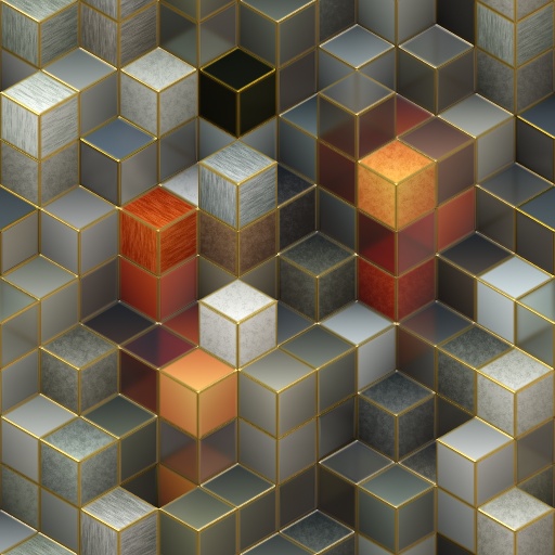

Has a few bugs and needs more user controls but the bones are there...
Cuberism Mapped.ffxml
Posts: 6221
smile:eek: smile:eek: WOW !!! WOW !! smile:eek: smile:eek:
I can´t believe what you have done !! This is really very good and looks excellent.
You did not know it BUT my next challenge I thought was having a BORDER control around the cubes and have it like chrome metalic, and in this you have already done the border yourself and is already included smile:)
Very well done and like it much, although in this one you do not have anymore the FILL control so you can have as many or few cubes, and the masking, but as you said well this is the bones of it and then after can be upgraded.
THANKS VERY MUCH FOR MAKING THIS BEAUTY OF FILTER smile:ff: smile:loveff: smile:ff:

I have updated the latest filter of Cuberism Mapped as I have found some problems when trying some large photos as they were shown too small, so I have added a zoom rescaling to each of the photos of the 3 sides, and also the ability to then after move the photo to be able to fit it inside the side of the cube in the best way
Also I have added 3 controls for chossing and customizing the colors of the Colourness, and also the option to make a texture overlay over the source photo in the left and right sides of the cube.
And have changed some names to be more meaningful and useful
Also now there is 11 presets. The preset 11 is the one using the Colorness as texturing, replace the left and right with your own textures
MASKING AND MISSING CUBES
I have included inside the filter the other 3 versions shown before of the previous versions of the filter, BUT until now I have not been able to make this filter work with masking or missing cubes as it happens in the previous versions, sorry.
In all the ways when trying masking the cubes gets modified or broken the tiles or images, or the cubes get cut because of the alpha, or other weird results
Although in the masking I got some bad results, but could make something, but in the missing tiles although have tried many ways and combinations did not get any possible result.
I have tried at least 5 ways for each of masking and missing cubes, with different combinations and settings and I do not know why it does not work, and have changed some components but neither the masking or missing cubes works as this is done in a different way than previous
The problem is that now is larger and have more related components and there are more possible combinations and possible ways to do it.
Cuberism Mapped updated.ffxml

Here is a masked version where the inverted mask of the FF Lifesaver with transparency
The missing cubes are the ones that over the masked area
Posts: 6221
Here is a masked version of the FF Lifesaver with transparency
Posts: 6221
Here is a masked version of the FF Lifesaver with transparency with missing cubes additionally inside the mask of the Lifesaver
