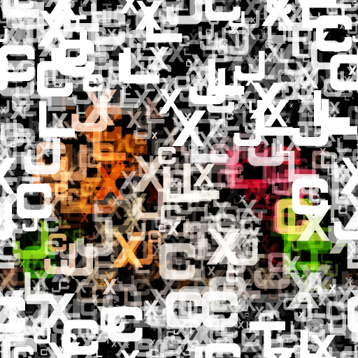

Here below is the graphical view of how a preset can change much when activating other options in the filter having all the same preset and same settings
Here is the original Preset 6 and how is changed below by just activating some checkboxes

1 - Black and white source
Considering that the filter will only distribute the letters over light colors and will decrease with darker color, and will not put any letter over black, you can design your own graphic frames with pure black and white, putting black wh ere you do not want any letter, so the size and width of the frame is the white part.
This is loaded the mask in the main image and does not need to activate masking to work, only load your black and white frame design and choose a preset (excluding presets 3 and 15 and on presets 8 and 9 you must activate main if you are not using tint color). You can also load the mask in the tint color, but you will not be able to change to another preset.
One reason to make it this way instead of using masking is that you can keep a black background behind the frame so is not transparent, and also you can do it from photoshop (or any other similar host) without having to save and load the frame
Here below is an example I have done using plain colors instead of image source colors and also using a black and white mask
